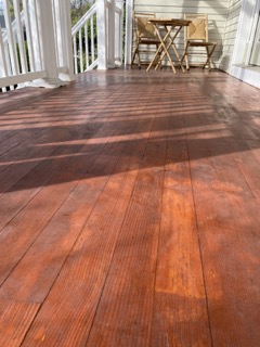

IMG 8776
I last finished deck in Sept 2019 and it held up well, bit is overdue now.
I just cleaned it and it looks dry and streaked. I’d like to try a water based product. I read the label but can’t tell if the PPG was water or oil based.  I live in Mansfield OH , between Columbus and Cleveland. Any

Strip and brighten for prep using this:
Stain with a water-based stain like the Restore A Deck or Defy Extreme.

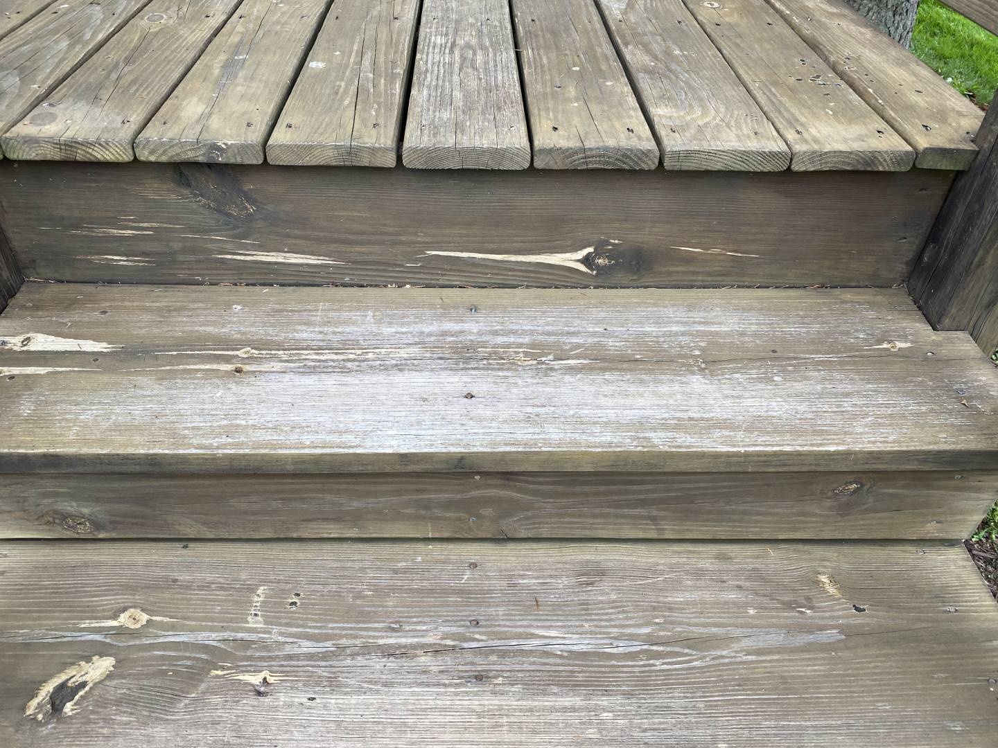

 IMG 5949 Small
