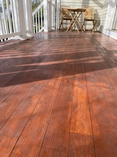

IMG 8779

(@lala58)
Joined: 2 years ago
I used Restore-a-Deck products for tripping, brightener and applied restore a deck stain in light walnut.
I’m very happy with results. I could have done a better job with stripper in some corners. I bought the kit with stripper and brighter but it didn’t have the gel/emulsifier and this might help if you’ve got a lot of spindles and deeper corners so the product stays in place to do it’s job.
It took me much longer than the YouTube video I watched. But I’m not a professional, and I’m probably much slower. The deck is 8’ x 12’ with 73 spindles, 7 steps, and 3 walls. Some of it requires a ladder.

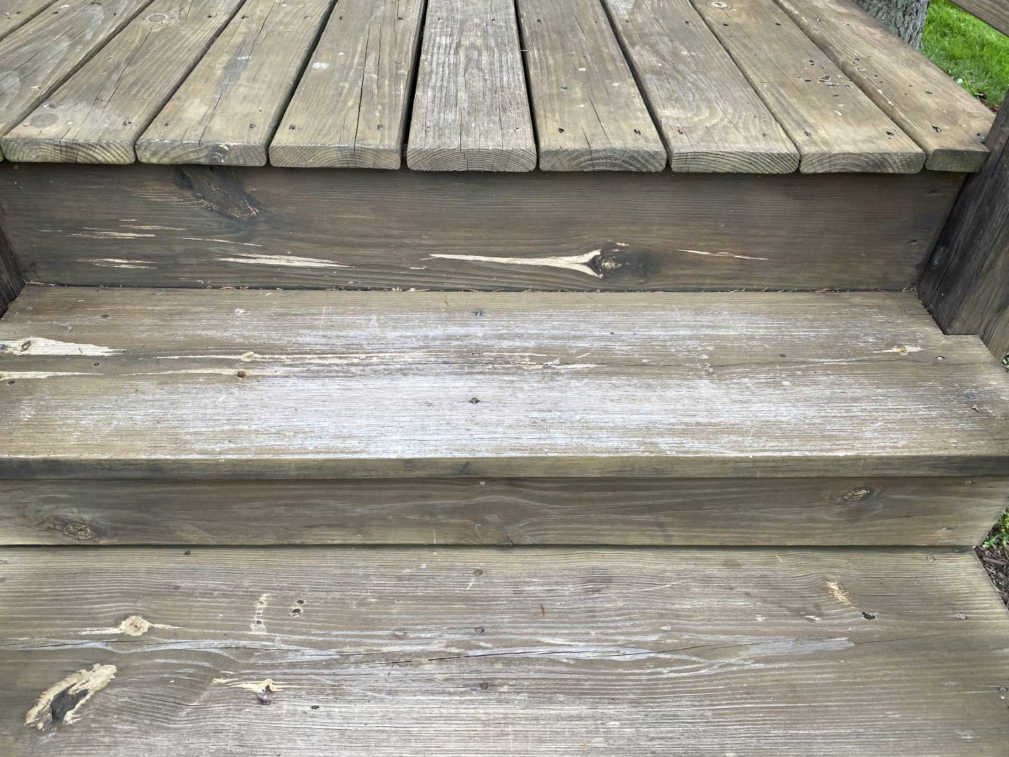

 IMG 5949 Small
