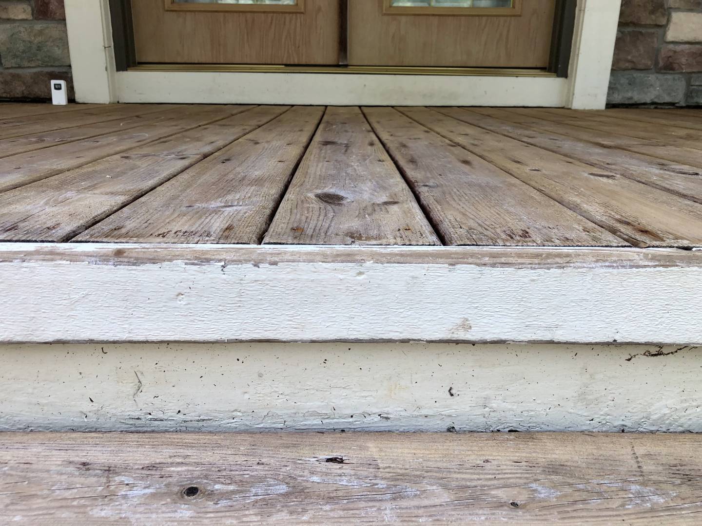

You can stain over this. We would use a solid stain for the trim board.
(@franz)
Eminent Member
Posts: 20
@administrator Hello, I didn't realize you had an article of recommended solid stains linked here to your answer.  I did already buy a qrt of PPG Ultra Creme. Should I try to return it and go with Defy?

(@administrator)
Posts: 3341
It is just a trim board (mostly vertical wood) so it probably does not matter that much what you use.

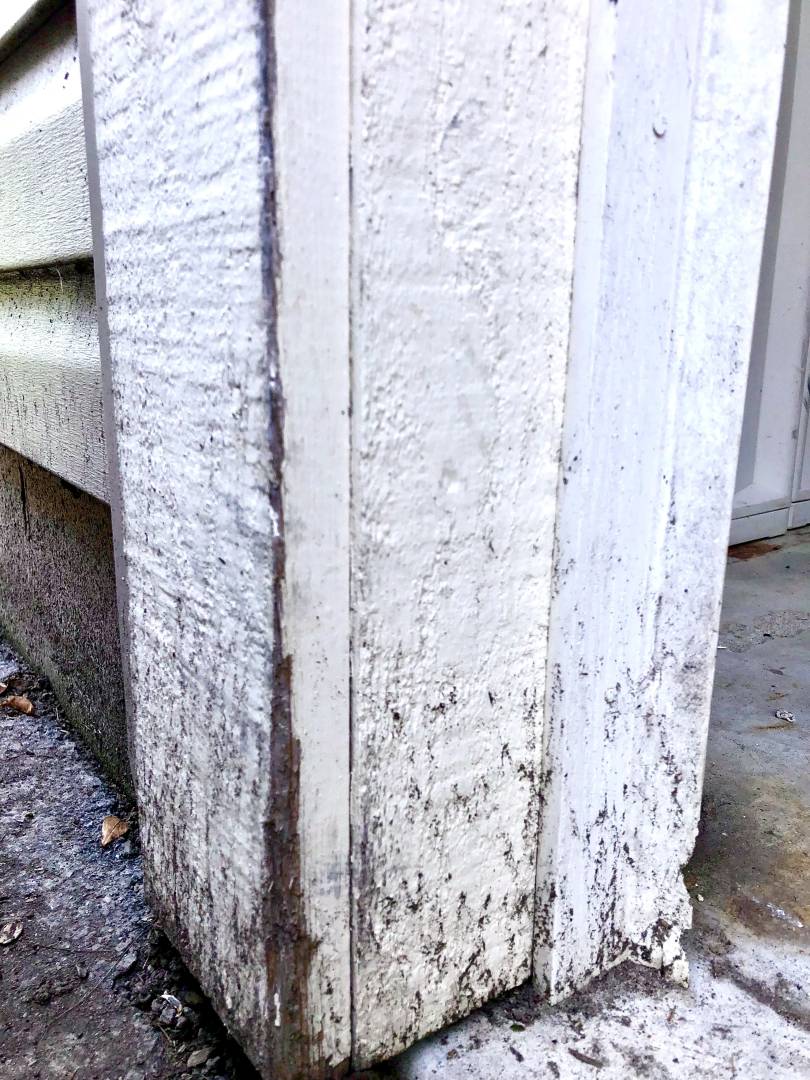

Posts: 20
@administrator
Just noticing this trim.  We actually have 'rough-cut' cedar trim boards and they are used all around the exterior of the house.  So to maintain the deck trim that is stripped, plus re-coat the peeling spots/knots around the rest of the exterior, we would like to see about getting the Defy in a custom cream, but not in a 5 gallon portion.  Do you know of a place who will tint (have name & sample of PPG color in can) a gallon of Defy?

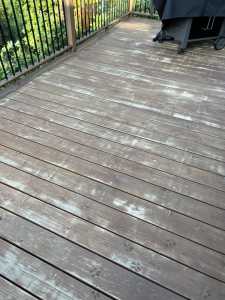

IMG 2281
I am going to restain this cedar deck in New Jersey. Has Defy extreme Semi-transparent on it. I sanded to remove scuffs and dog scratches, etc. I also used a deck cleaner (before sanding). Planning to use same stain.
Am I right to be concerned that the stain will not absorb evenly into the deck? If so, what are my best options. Tia.
(@administrator)
Posts: 3341
@billybgood Yes, it will be uneven at this point. You should remove the Defy fully now to get it even. Strip and Brighten.
