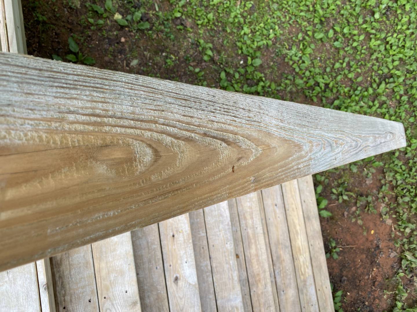

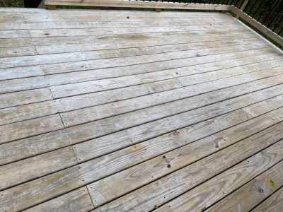

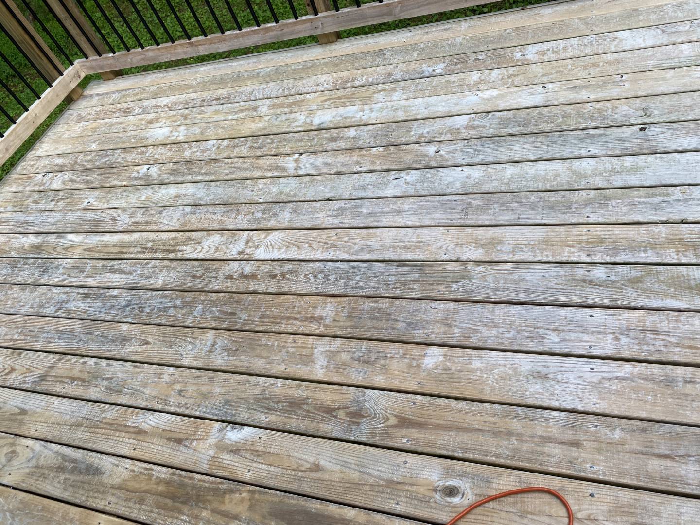

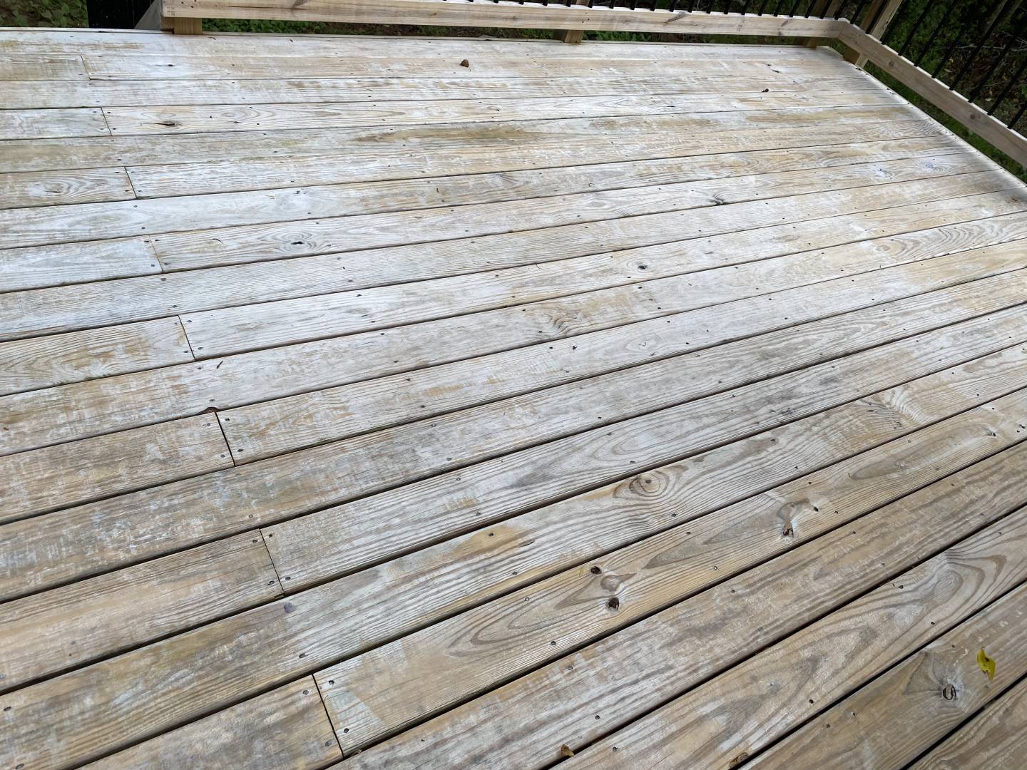

(@scooby23)
1ECB3111 E6E8 48C4 AB84 3146CFD0CCBE
3D0ED664 A657 40DB 8A93 669F8755C707
629C2E7B DD4D 481F BFDC B3183A5E33F4
I live in South Carolina. I had my deck rebuilt with pressure treated lumber in 2021 and yesterday I cleaned (with a scrub brush and power washer) and used brightener(RAD) Now I have white fuzzies and white marks on my boards. Do I need to reclean or just sand?
Posts: 3341
That is oxidation that did not come off. Redo prep using the RAD Cleaner and then the Brightener after.
