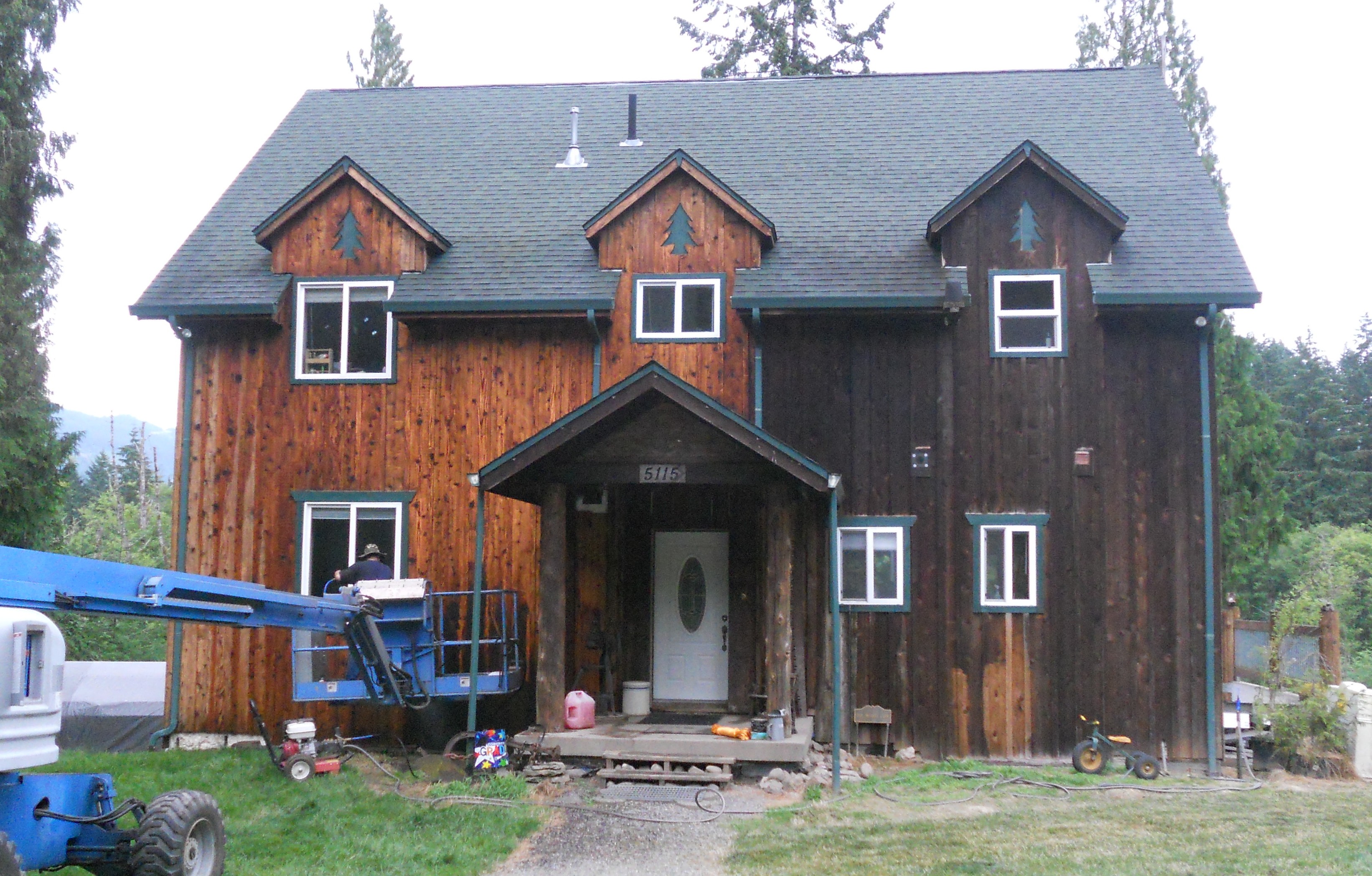

I have read alot about deck stains, but am unable to find much information about natural cedar siding. Do you have any suggestions on what we could use on our house. We are just now pressure washing off the Penofin that was applied 9 years ago and turned black within 2 years. We live in the wet Pacific NW.
Please see the attached photo.
Cleaning up well! I would look at TWP 1500 series or Armstrong Clark for this dried out cedar home.
