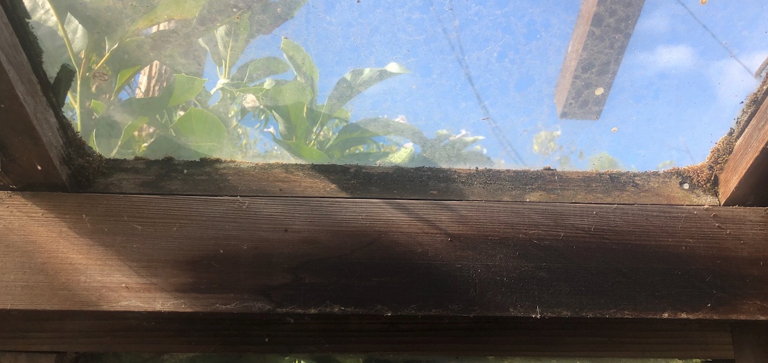

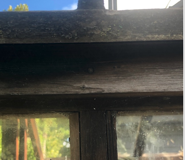

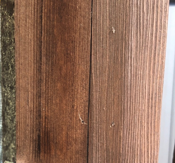

I am restoring my weathered greenhouse made of the old growth redwood and it's located in the west coast of USA. It will be used as outdoor dining patio. As you can see on the photos - I am having an issue that the post does not allow pdf.
Img - exterior worse one --> one of the worse shape of the wood
Image - interior with moss and possible mildew
Image - interior better shape

Interior with moss
Interior   Better One
Exterior   Worse Shape

You will need to pressure wash while suing the RAD Prep. Will that work in your interior areas?
The RAD Stain will work better and prevent mildew and algae better than the oil-based stains.
