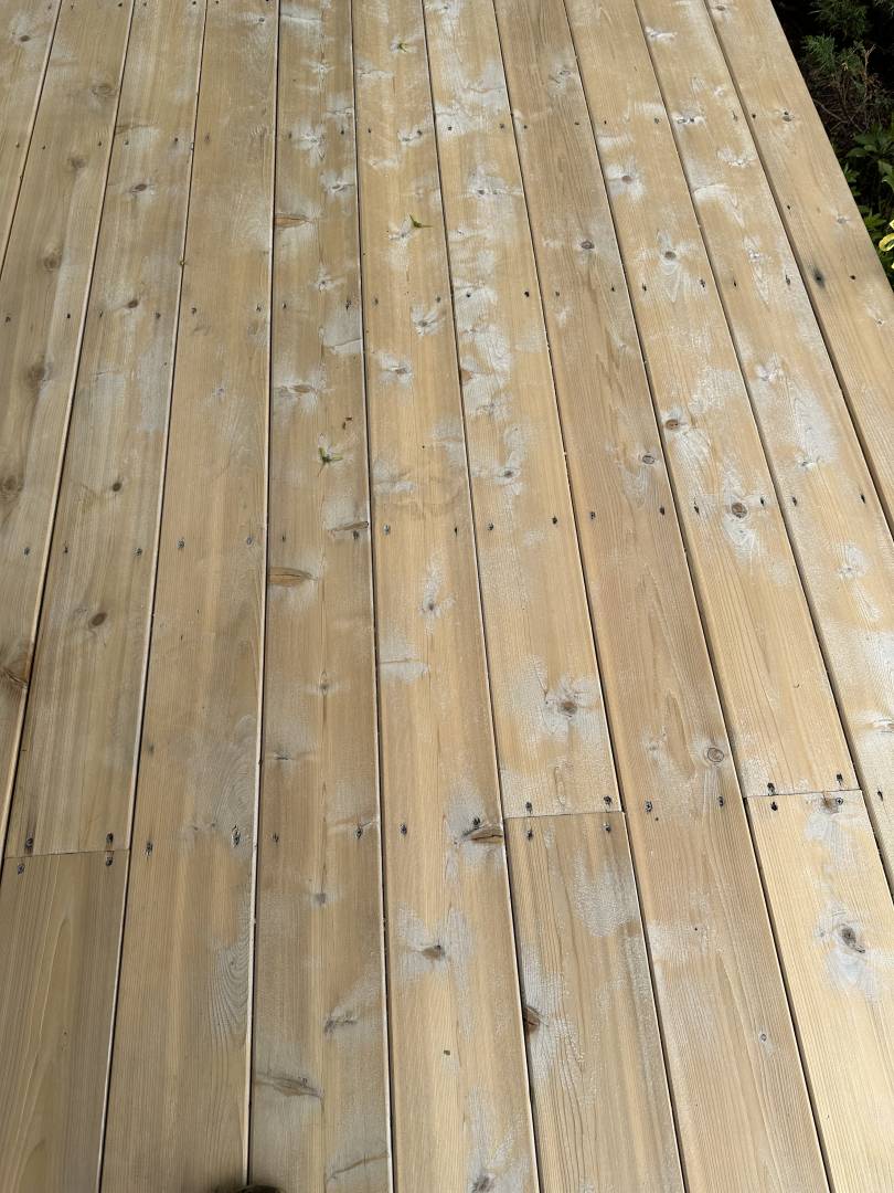

8 month old new kiln dried cedar deck is prepped with restore a deck cleaner and brighter, Now has white spots. We are ready to stain with TWP 1500 cedartone. Are the whit spots an issue and do we need to do something additional to prep properly? Thanks.

The white spots are part of your wood knots. Not an issue.
