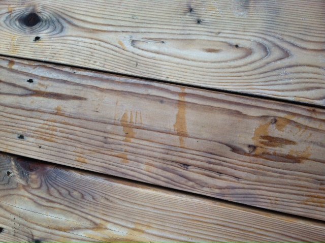

I have a cedar deck that I let weather for 1 year. Planning on putting oil stain on deck. So I tried cleaning deck with Pittsburg Paints Ultra Deck Cleaner. I applied cleaner as director using garden sprayer. I then washed deck down with power sprayer with medium stream "no high water pressure". I started to notice a white film on the deck boards. Didn't know if I should wash off which would take higher water pressure and lots of work. I didn't know if I was cleaner damaged wood. I left deck to dry and that's where I am now. What do I do now? See photo
Posts: 3381
That is damaged wood cells that need to be removed. The cleaner loosens this so you can heavy scrub or pressure wash off. Try a little more pressure and ti will come clean.
(@jimneb)
Joined: 12 years ago
I just wanted to make sure the white film wasn't part of the wood composition and I wasn't damaging wood? Never said on deck cleaner that I would have to do anything like this. It just says, "Rinse off". The film is gummy and will take alot of work to get off.
Posts: 3381
This film is from the sun UV damage of the wood cells. Yes it needs to come off first.
