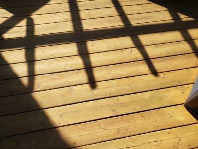

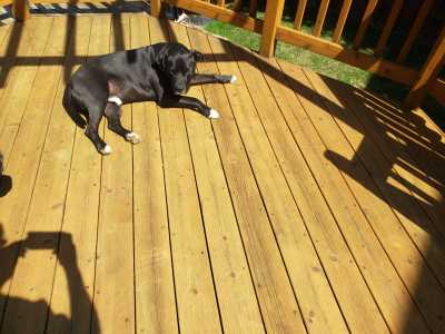

Stained my Deck with TWP cedar stain in 2021, loved the stain, actually lasting longer than the other stains I've applied.  The stain still looks pretty good, (see pictures attached) i just want to wash it so it looks cleaner and maybe a little brighter.
The store-bought cleaners I believe will still remove some stain which i don't want. More intended to clean before staining again (I believe).  I just want to clean it and remove some of the mildew building up, I don't want to stain again this year.
What type of cleaner do you recommend I use..?  Can i use power washer with circular attachment. (Karcher t300)
20230413 120741
20230413 120851
 Thanks for your help.
(@administrator)
Posts: 3341
You should only use a deck cleaner if you plan on restaining. Use this for the mildew.
