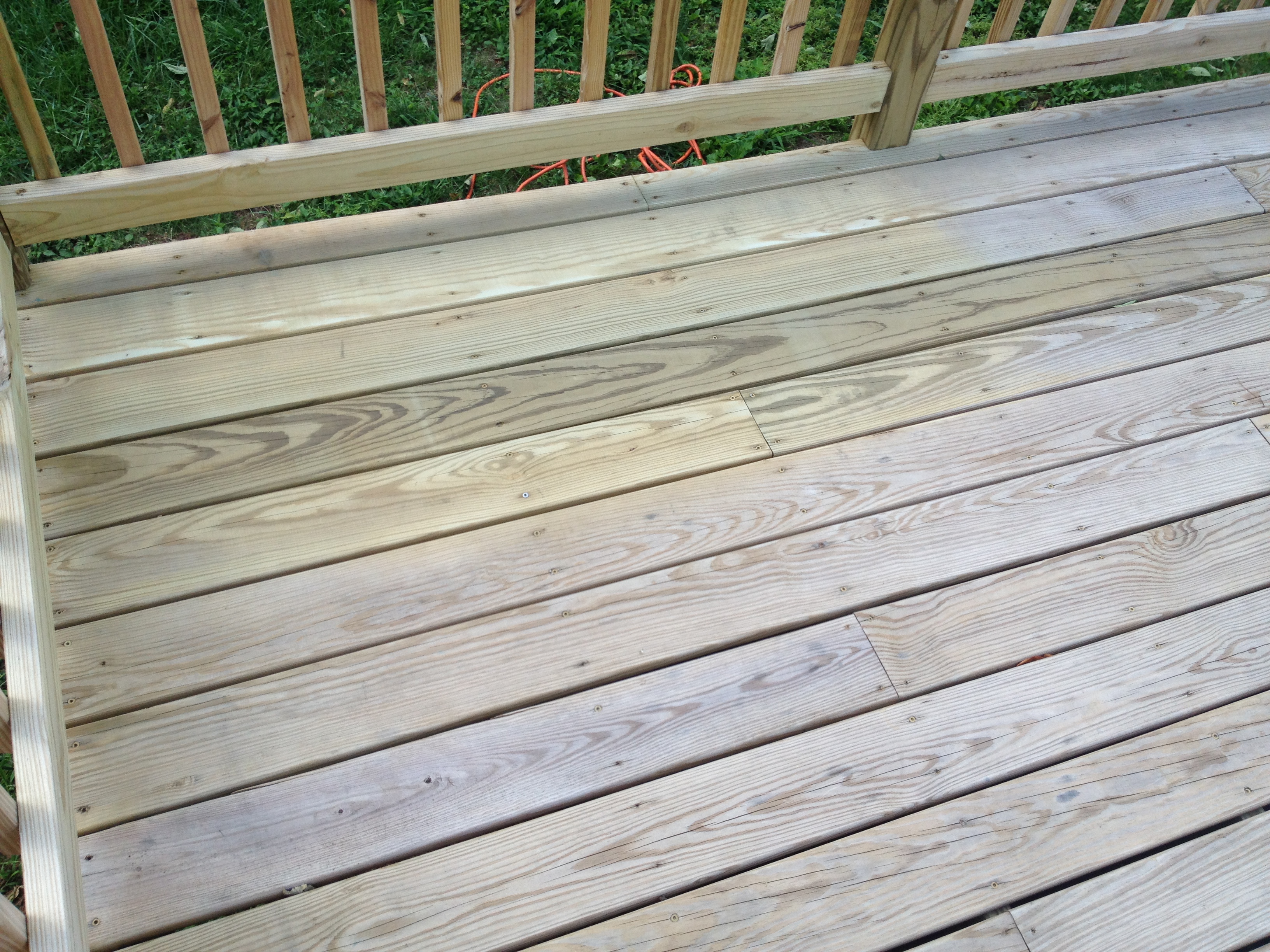

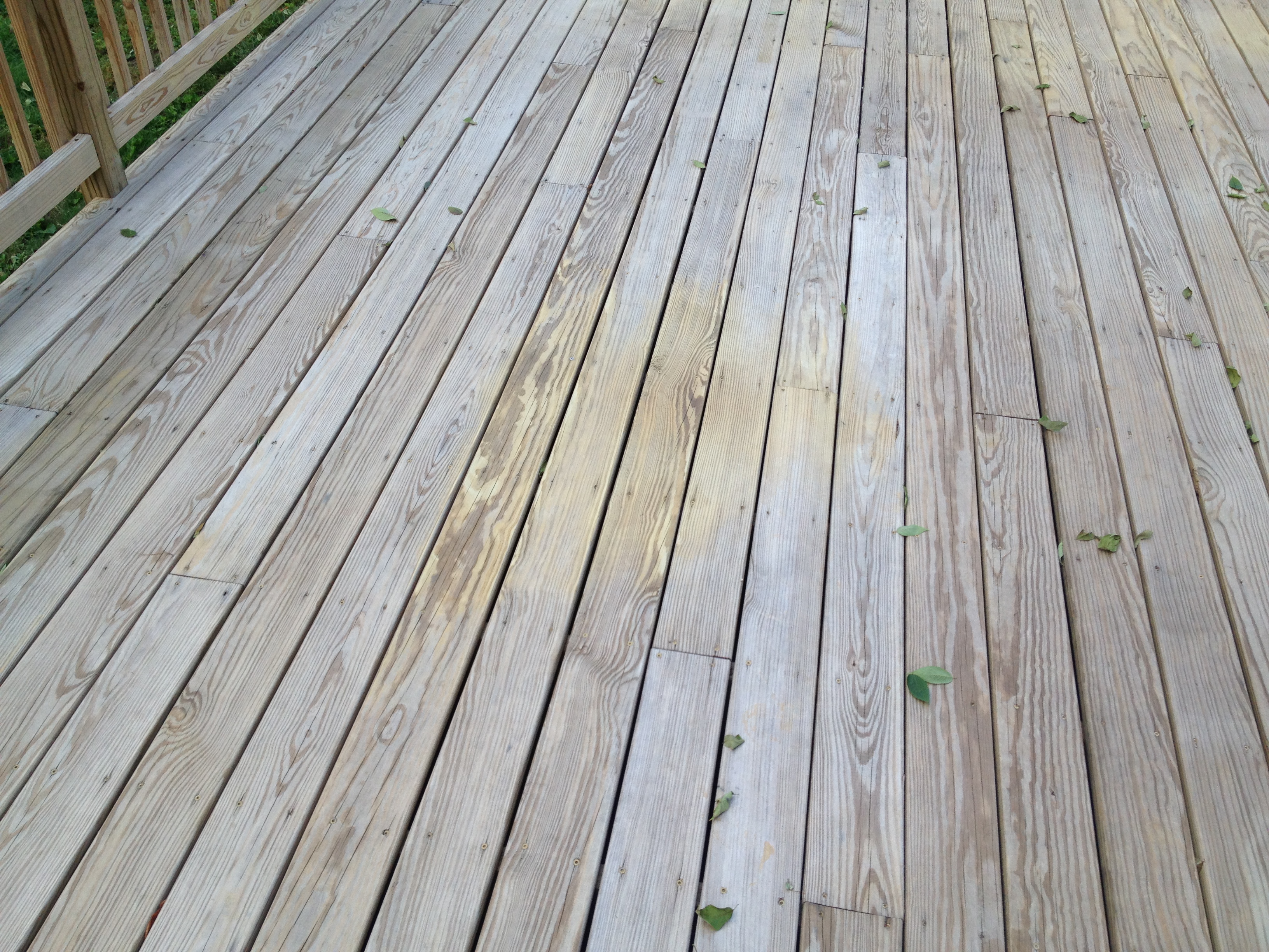

I have a pressure treated deck that is about a year old and was planning on staining this week. I noticed that the areas that had the grill/furniture are darker in color. I used the restore-a-deck 2 part system and while the deck is brighter, I still have these patchy areas.
What to do?
Posts: 3384
Did you pressure wash or heavy scrub after applying the cleaner? That is gray fibers and should come off with a little work.
(@skleice)
Joined: 13 years ago
I figured the problem was that my scrubbing efforts were uneven. I just gave it a nice pressure wash (small investment) and it looks much better already. I'll know more once it dries. Thanks for the reply.
