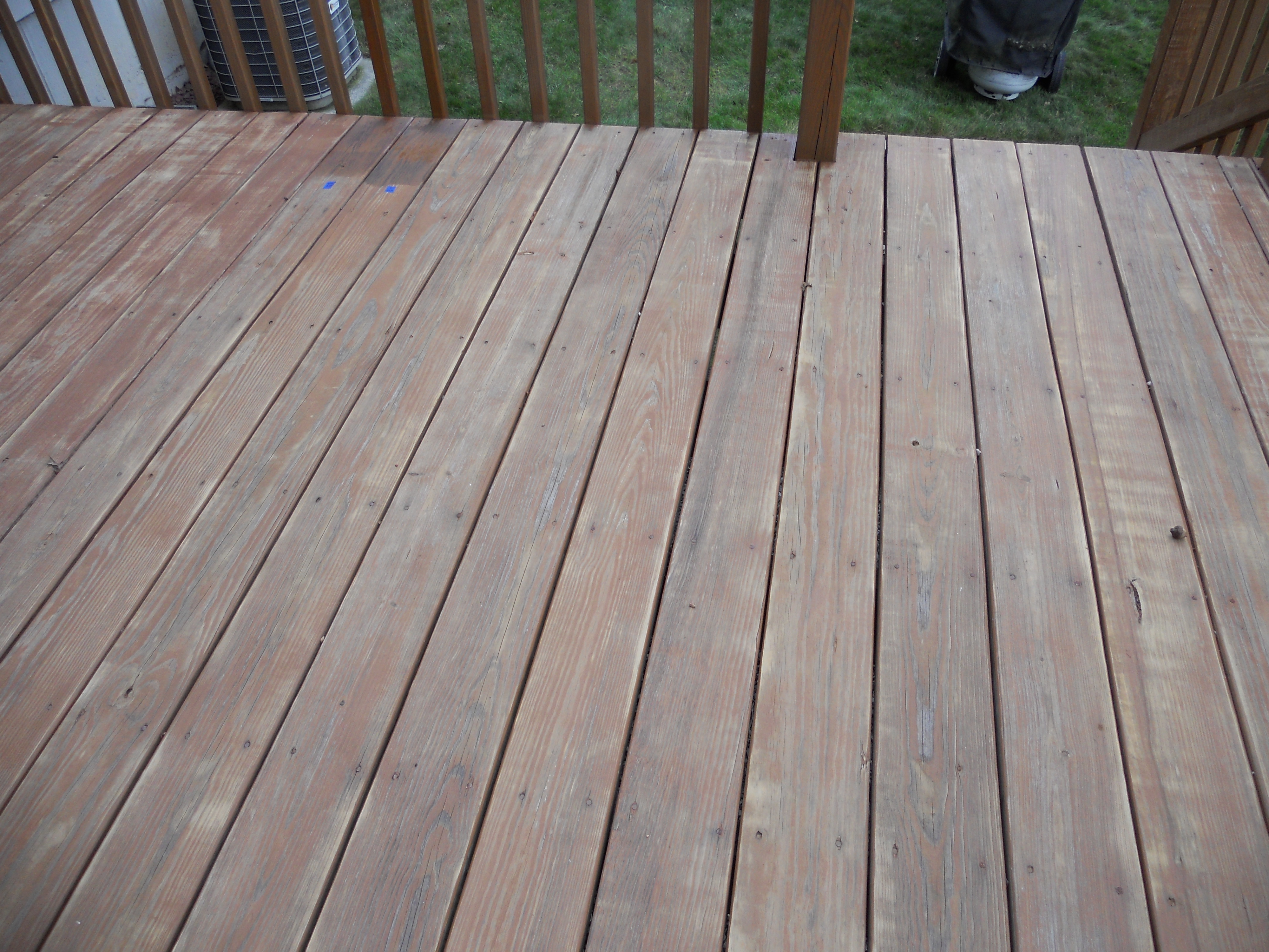

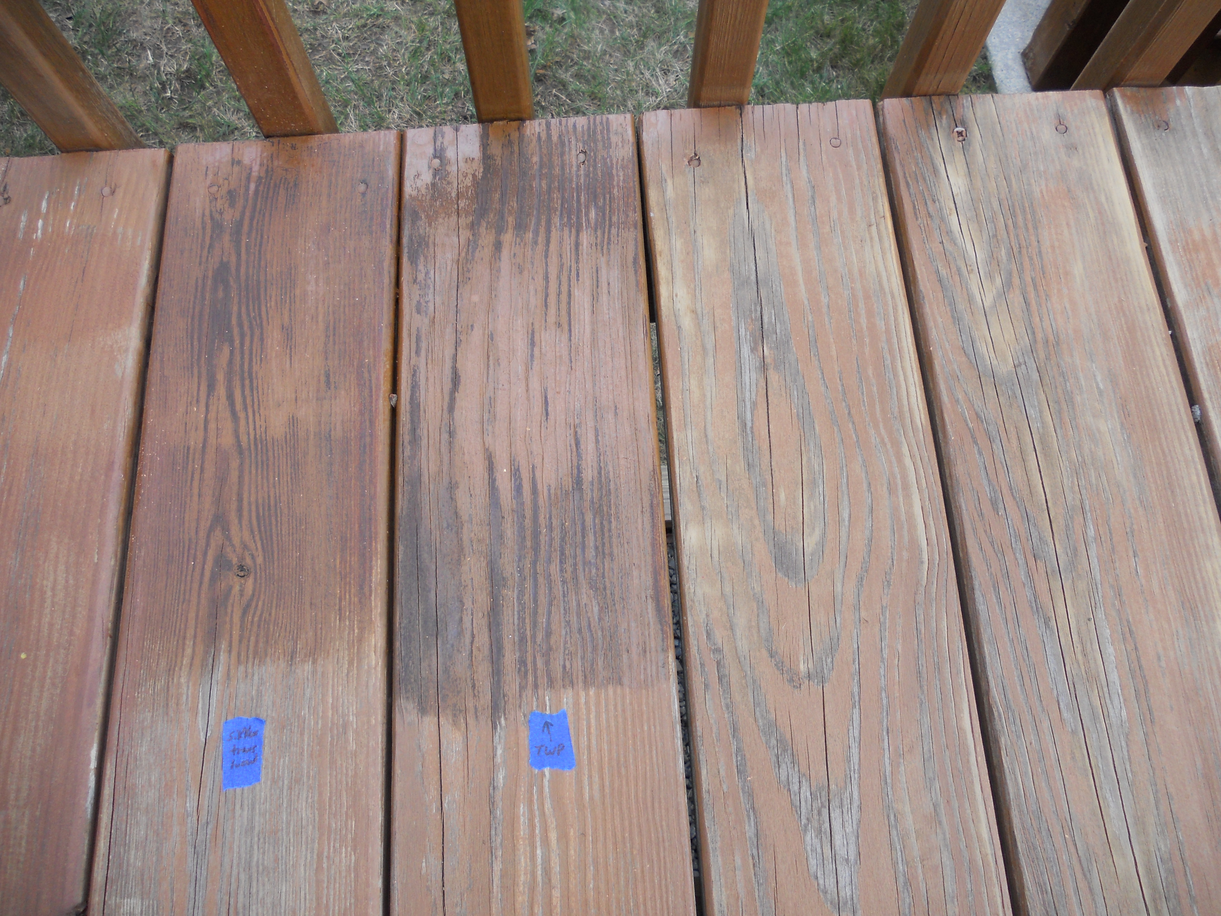

Here`s a photo of the deck.
Tried Sikkens translucent cedartone on left.
Tried TWP 1501 cedartone on right.
Both look terrible..............the black appearance of the wood grain after the stain application doesn`t look good.
The only prep the contractor did was powerwash with TSP, then litely sand. The sanding was very inconsistant.
What would correct this poor appearance before we stain the entire deck with the TWP semi trans cedartone.
I want to see the grain, not hide it. Thanks.
Posts: 3381
You have a lot of old stain that needs to be removed. I would strip it all off with a deck stain stripper then follow up with a wood brightener.
