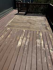

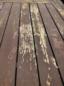

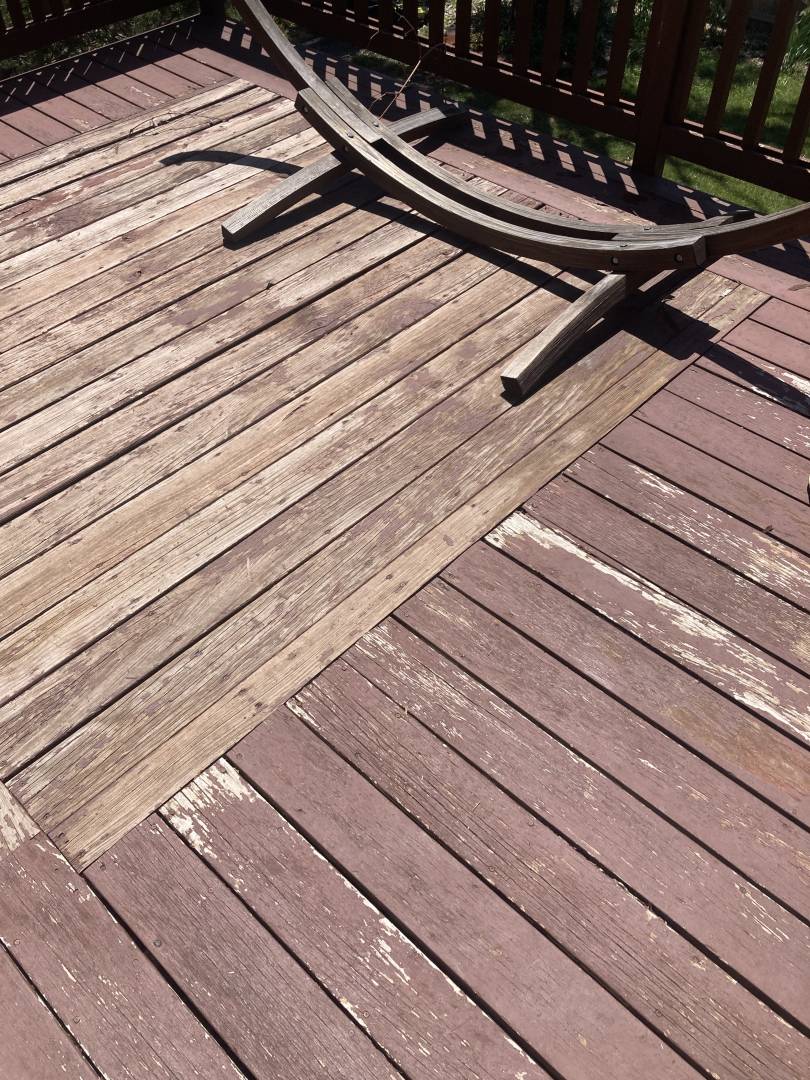

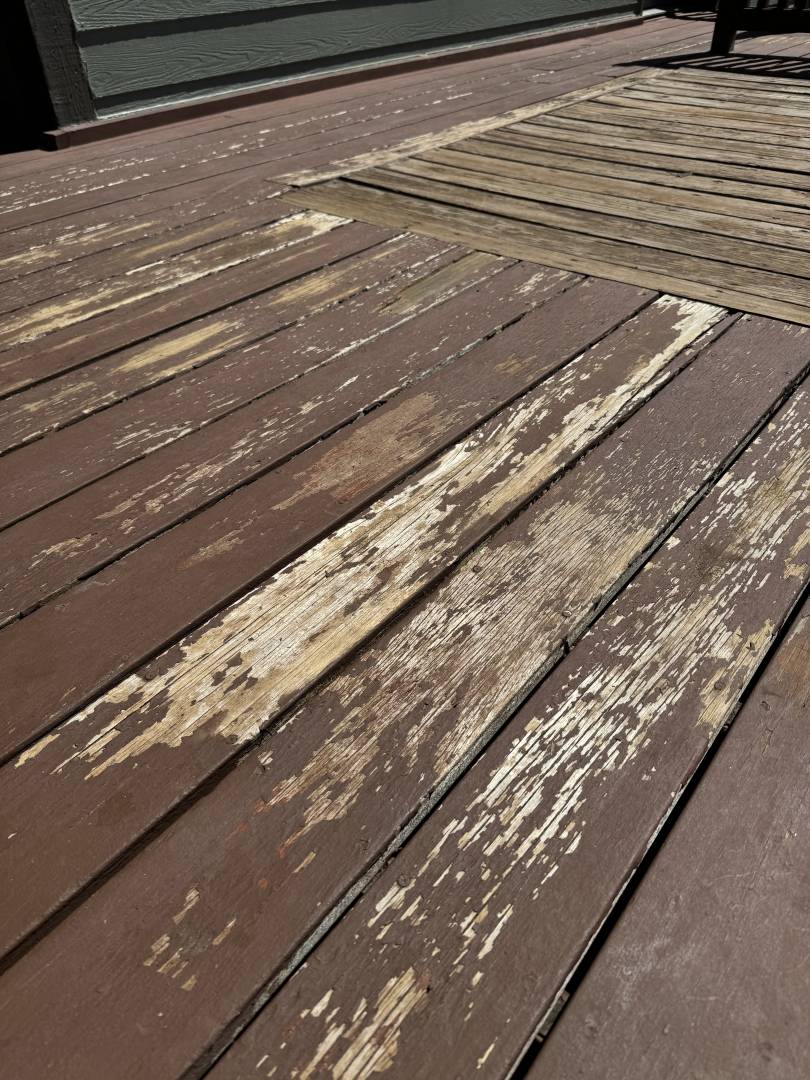

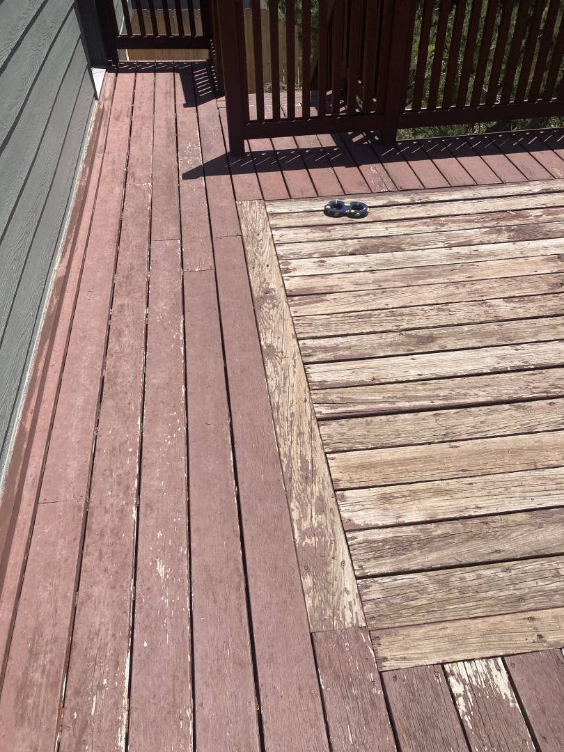

(@decker)
Joined: 2 years ago
Posts: 7
IMG 9774
IMG 9778
IMG 9779
IMG 9777
(@administrator)
Posts: 3341
Concentrate most of the prep on the horizontal wood. Use a Deck Stripper and pressure washer to remove as much as possible. Let dry and spot sand as needed. You can cover the intact non non-peeling stain with a new coat of solid stain:

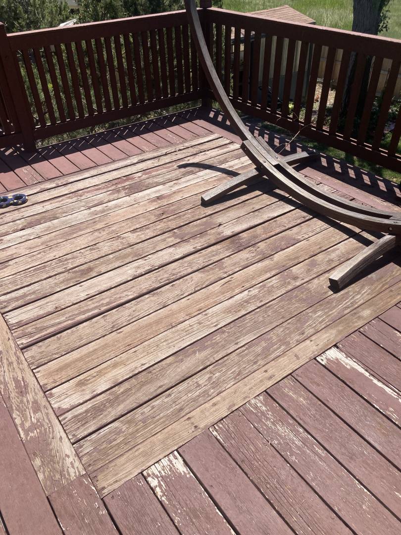

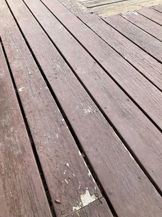

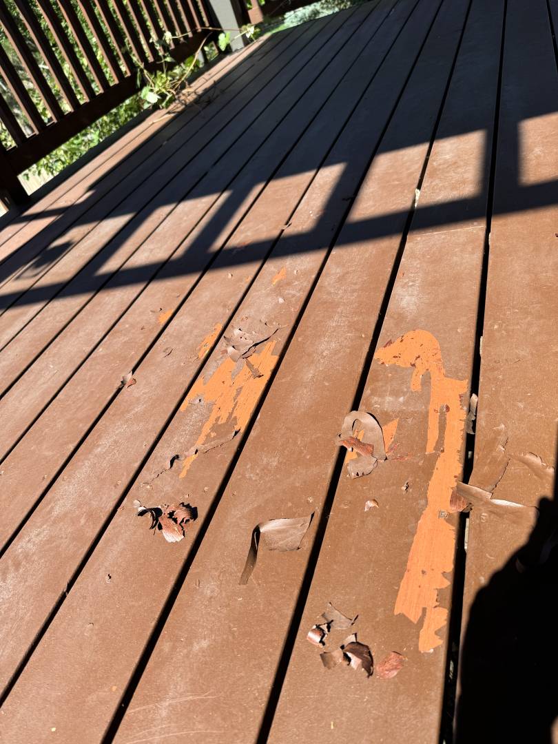

(@decker)
Joined: 2 years ago
Posts: 7
IMG 0154
IMG 0152
IMG 0153
IMG 0151
IMG 0155
@administrator how long after brightner do I need to wait to stain?
is brightner needed if only doing solid stain over the wood?
I have used a stripper yet, but did power wash and scrape/sand a few areas. Do you still think I need to use stripper or could I solid stain right over this?
(@administrator)
Posts: 3341
See this for recoating with a solid stain:
(@decker)
Joined: 2 years ago
Posts: 7
@administrator yea I read that but since I power washed, scraped, and sanded loose stuff. Is a chemical stripper really necessary if everything loose has been removed? Trying to avoid chemicals if possible.
I also don’t want to pressure wash again and wait about 2-3 days to dry.
I posted pics above if you’re able to see.
(@administrator)
Posts: 3341
Maybe, but it is about having a solid foundation for recoating. We would do the strip but up to you.
(@decker)
Joined: 2 years ago
Posts: 7
@administrator if power washing the strip back off, do I NEED to brighten? And should I wait 48-72 hours since power washing gets deep
thanks.
(@administrator)
Posts: 3341
Yes, to both.
