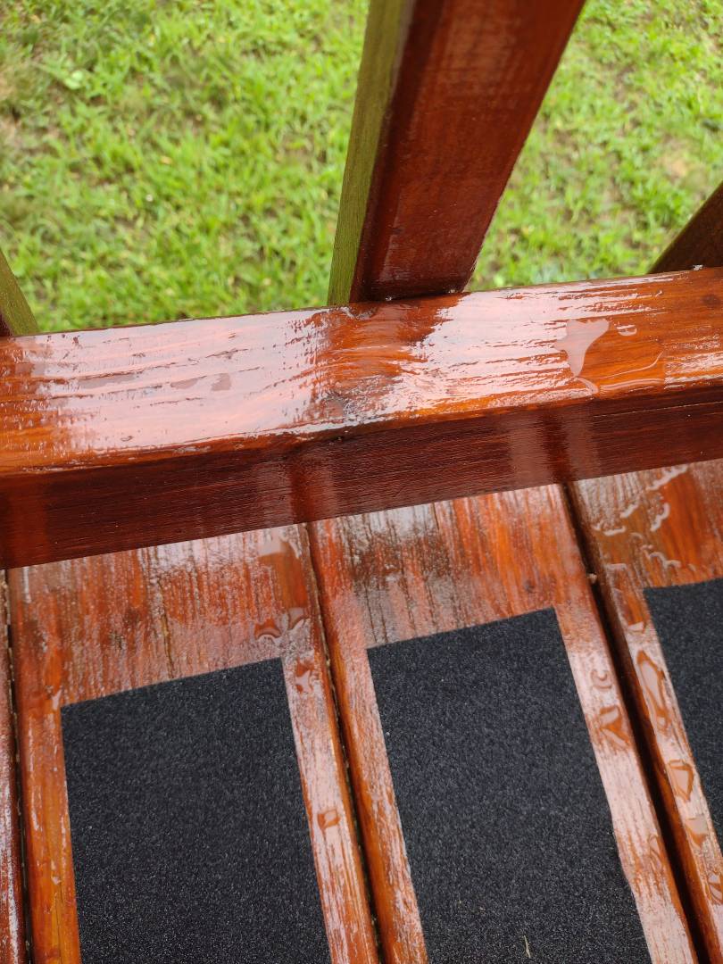

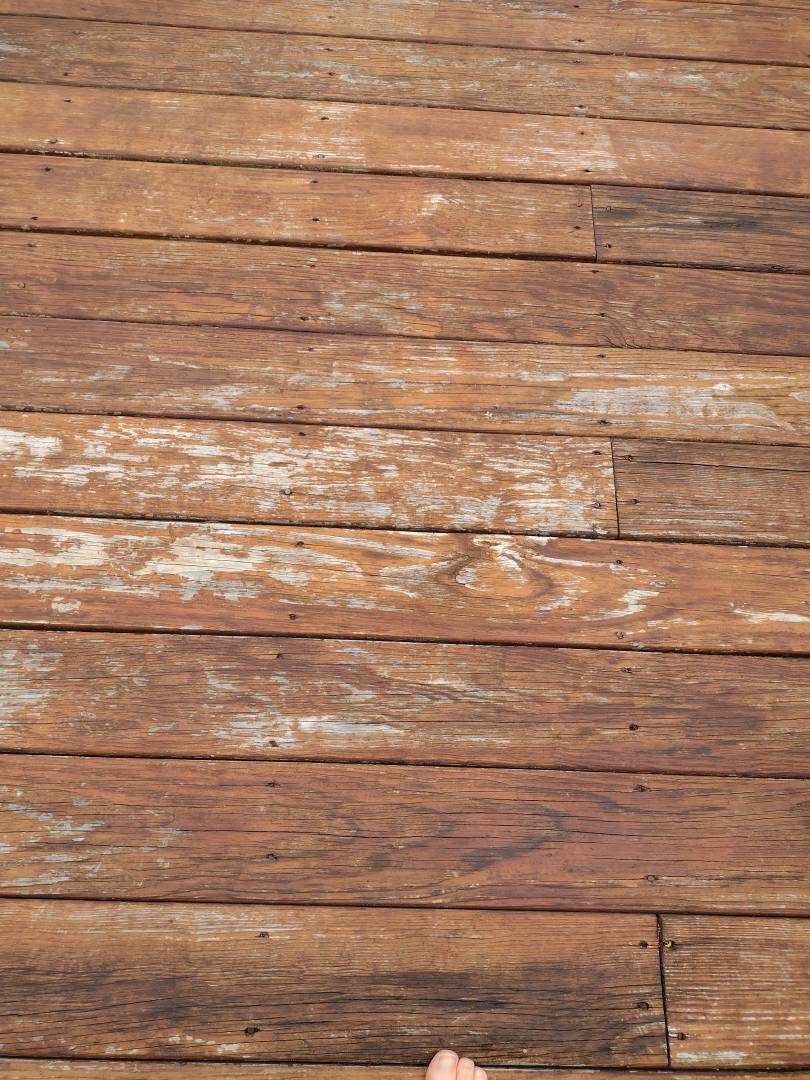

Hello, I would appreciate some advice about my decks. We have 2, a small side deck and a larger back deck. We bought the home 5 years ago, the home (and presumably the decks) were 7 years old. About four years ago I re-stained the deck with Behr Waterproofing Wood Finish, which was the brand the previous owners used. It looked good, but started peeling 2-3 years later (I am not sure I used brightener after destaining). I was recently told by a family friend to use urethane as a top coat after the stain next time.
So earlier this year we did the side porch, and used Varathan Spar Urethane as a top coat. It looks ok, but was too smooth and slippery (even though we added Behr Anti Slip Finish Additive to the top coat) so we had to put down anti slip tape.

Was it stained prior? If so, we need to know the brand and type of stain and pics for proper prep advice.
 lkn8
(@lkn8)
Joined: 5 months ago
It was stained initially with transparent Behr Waterproofing Wood Finish (Cedar Natural tone), and that is what I restained with 5 years ago. It started peeling after a couple years, but then I got pregnant and had a baby so this summer is the first time I have been able to get around to it again. I was thinking to do the Behr Waterproofing Wood Finish again (mostly because then I don’t need to redo the side rails as those still look good) but use TracSafe anti-slip sealer as a top coat on the floor boards. The pictures above are the only recent pics I have unless you want pics of the can of stain.
