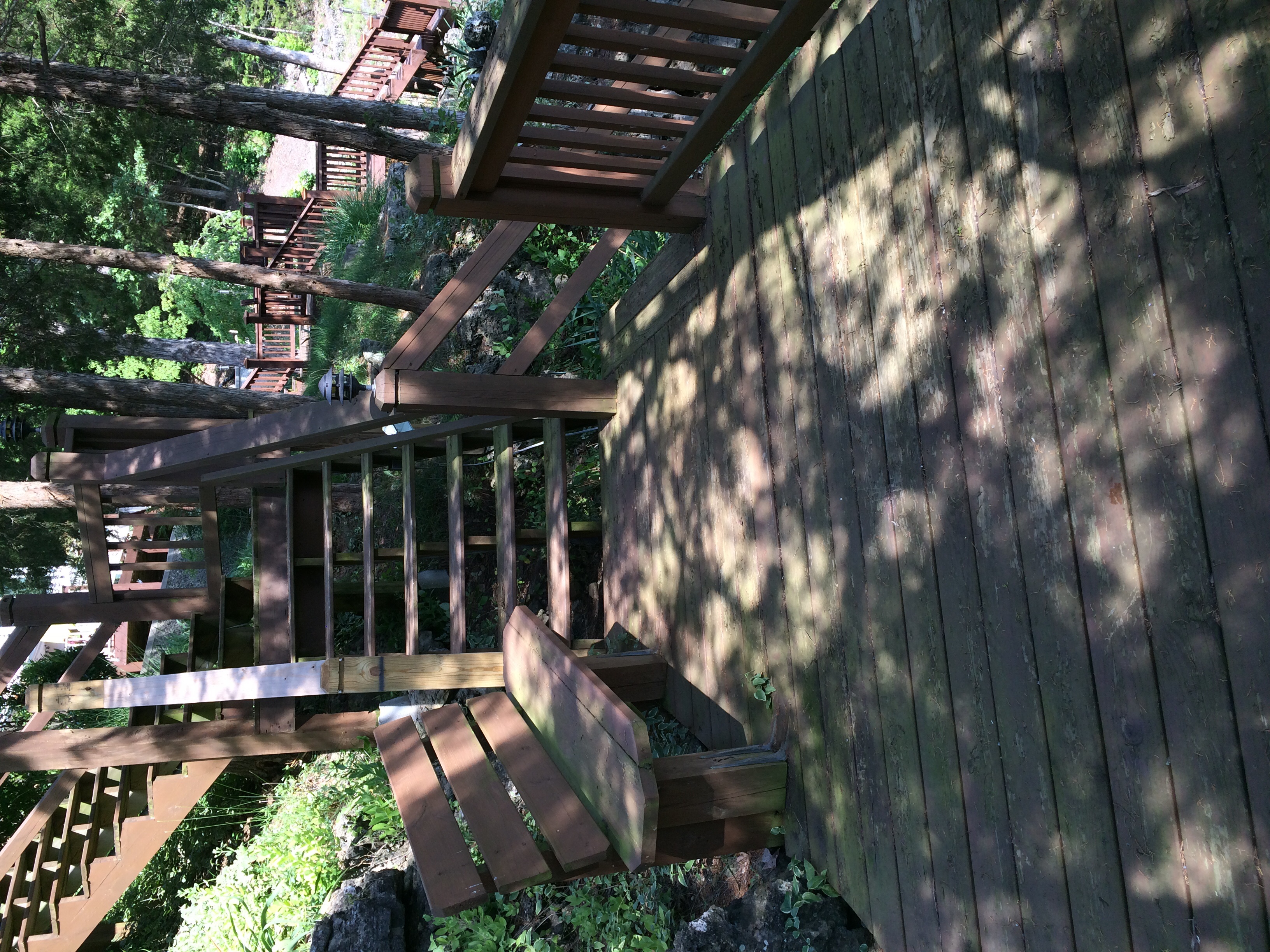

We bought a lake house a couple years ago with a 12 year old pressure treated deck that needs some attention.
Location: lake of the Ozarks missouri so pretty humid summers.
Lumber: pressure treated pine. Most is 12 years old but some is new where we added on or replaced. All new has been weathering for at least 6 months.
Exposure: most is partial to full shade
Mold/mildew: green mold or mildew is present in many areas
Reason for failure: old stain is peeling off in many places. Guessing it has been at least 3-4 years since anything was done to it. Mold and mildew too.
What is the best method and product to clean it and then re-stain? Probably a solid color, maybe semi transparent. Have about 1000 sq ft and 60 stairs.
(@administrator)
Posts: 3341
Is that a solid stain that is currently on the wood? I think so but hard to tell 100%. Do you have a picture of the verticals/railings?
Also a picture of the lake view would be nice! It has been cold this Winter!
(@administrator)
Posts: 3341
I can see the rails now after clicking on pictures. It is a heavily applied Behr stain. It most likely will not come off 100% so you will probably need to solid stain. Start by stripping off what you can. Use a stripper like the Restore A deck stripper and pressure wash. Concentrate on removing all loose stain, dirt, algae, and mold. Once done you will most likely remove most from floor but maybe 1/2 of old stain from rails. This will be okay to apply a solid but a semi-transparent will not work. You can go with any color now but IMO, I would keep it in the browns to blend with your woodsy surroundings. Look at Floods Solid Decking Stain.
