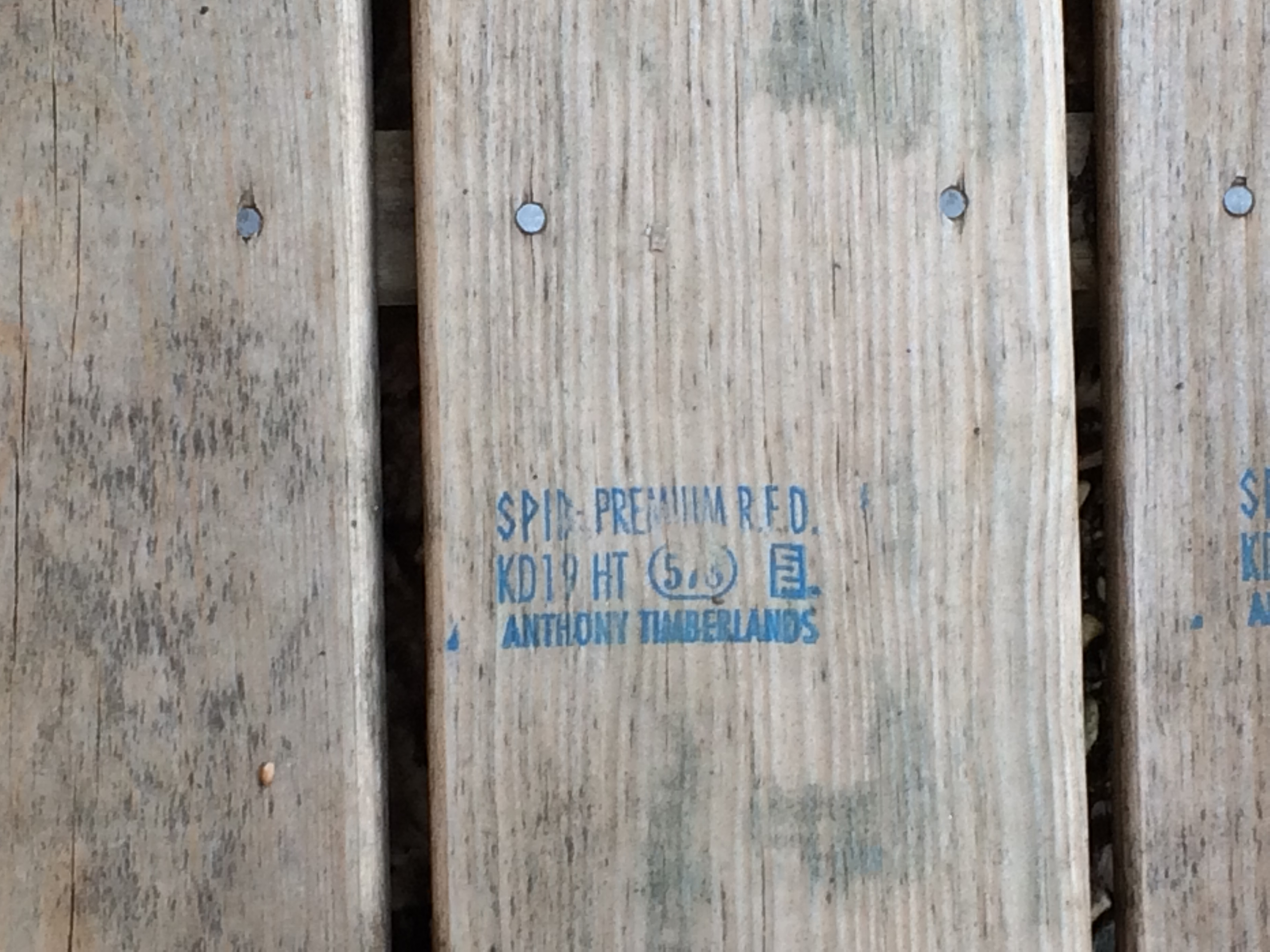

(@midnight)
Joined: 11 years ago
I bought a house in December. There are two decks that had been installed the previous May (one year ago). The previous owners did nothing to the decks and told me that they should be stained this June -- so 13 months after installation.
There are already splinters and splits so it seems like something should be done soon.
1. State you live in: Massachusetts
2. Full Shade, Partial Shade, or Full Sun: all three, depending on area and time of year
3. Type of Wood: Printed on wood: SPIB PREMIUM R.E.D. KD 19 HT
4. Mold or Mildew Issues: A little
5. Main Issues with Previous Stains: There were no previous stains
Image attached.
What should be done now to fix the damage that's been done and to protect it.
Also, is it OK to sand off the writing on the deck? It's in a very visible spot.
(@administrator)
Posts: 3341
Cleaners will not remove the stamps but sanding will. Problem is if you spot sand than the stain will absorb differently, creating spots. Best to sand these off now. Wait a month and clean and brighten the deck with a Restore A Deck Kit. Stain with TWP 1500 Series.
