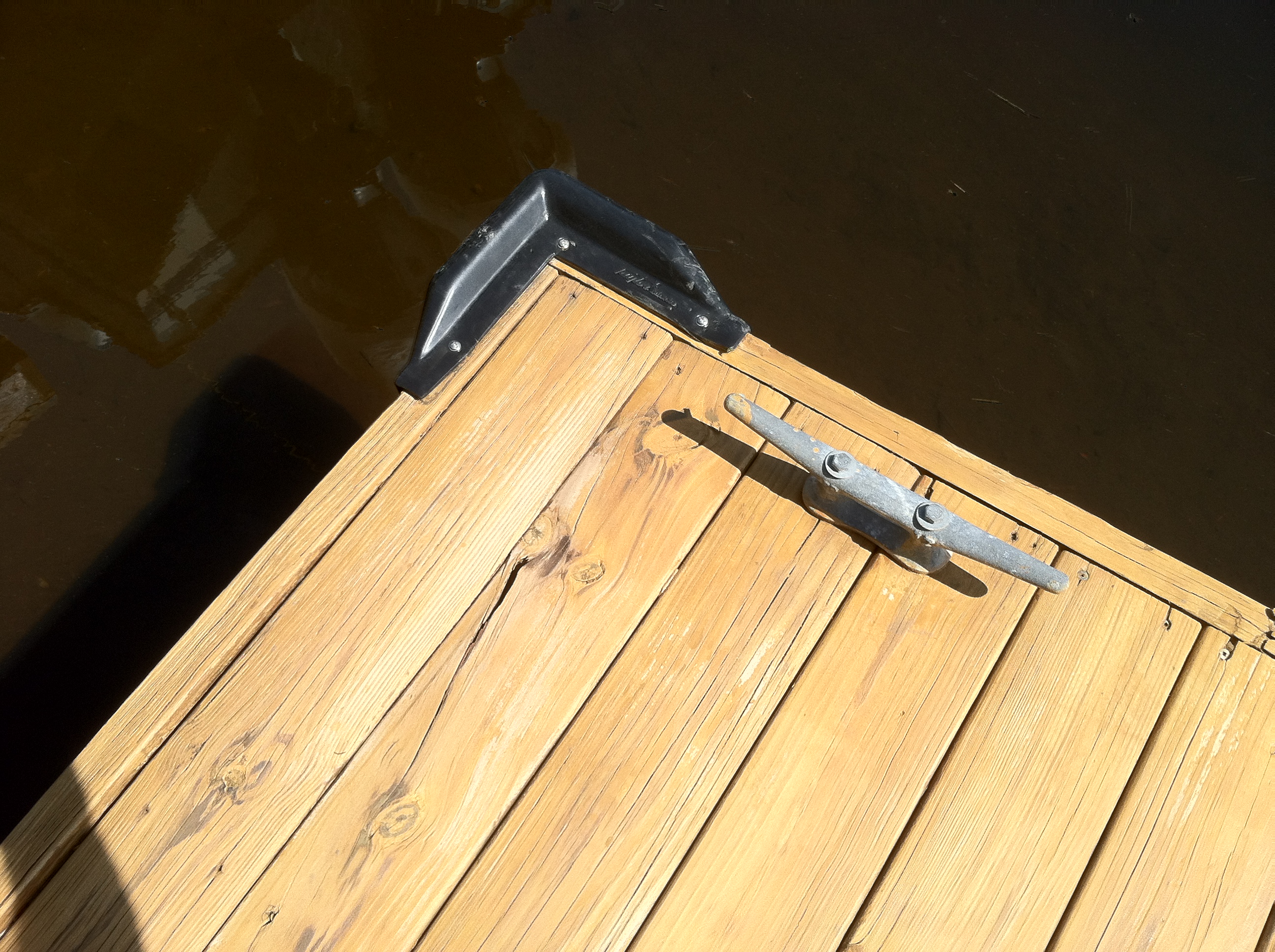

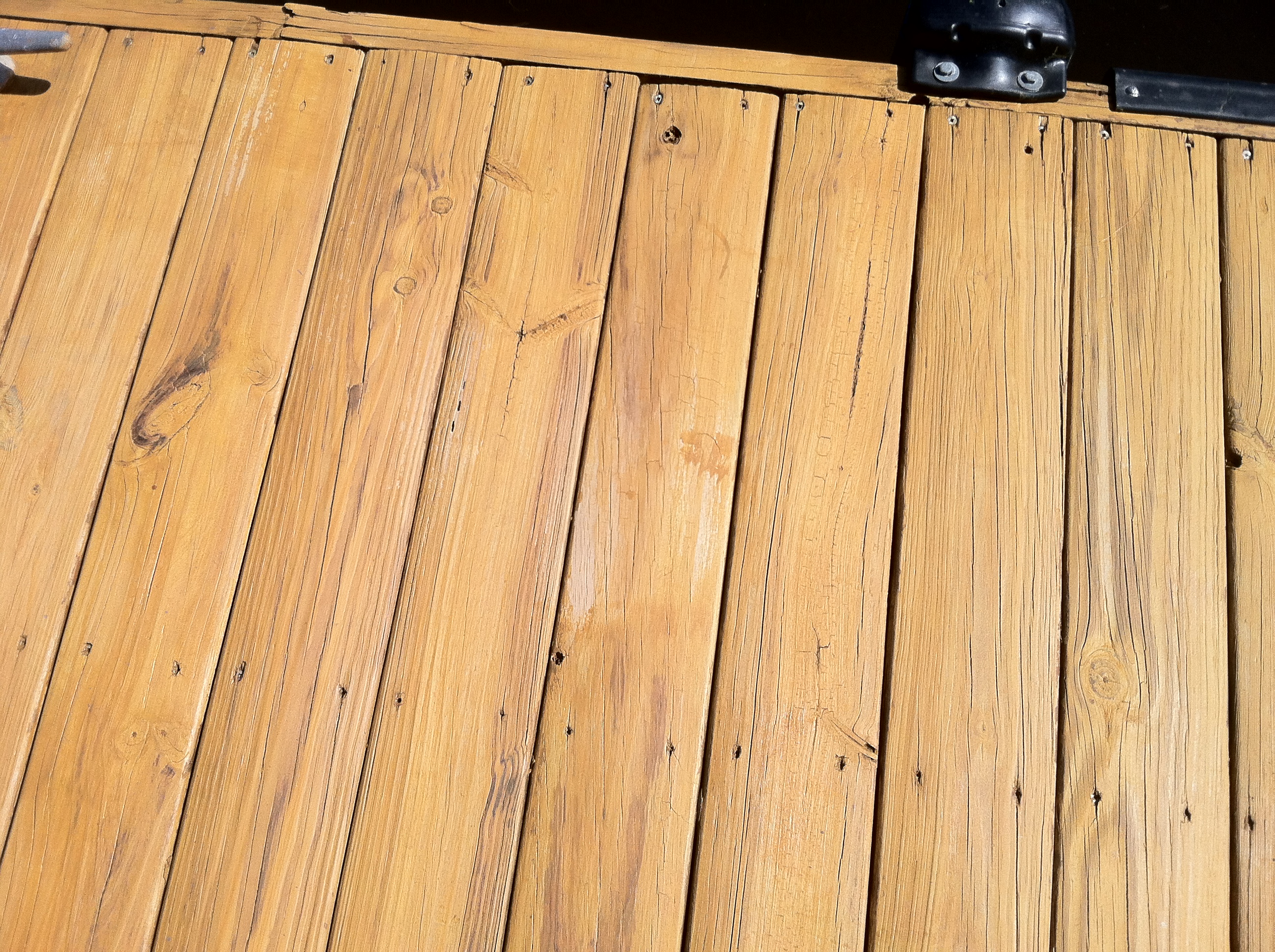

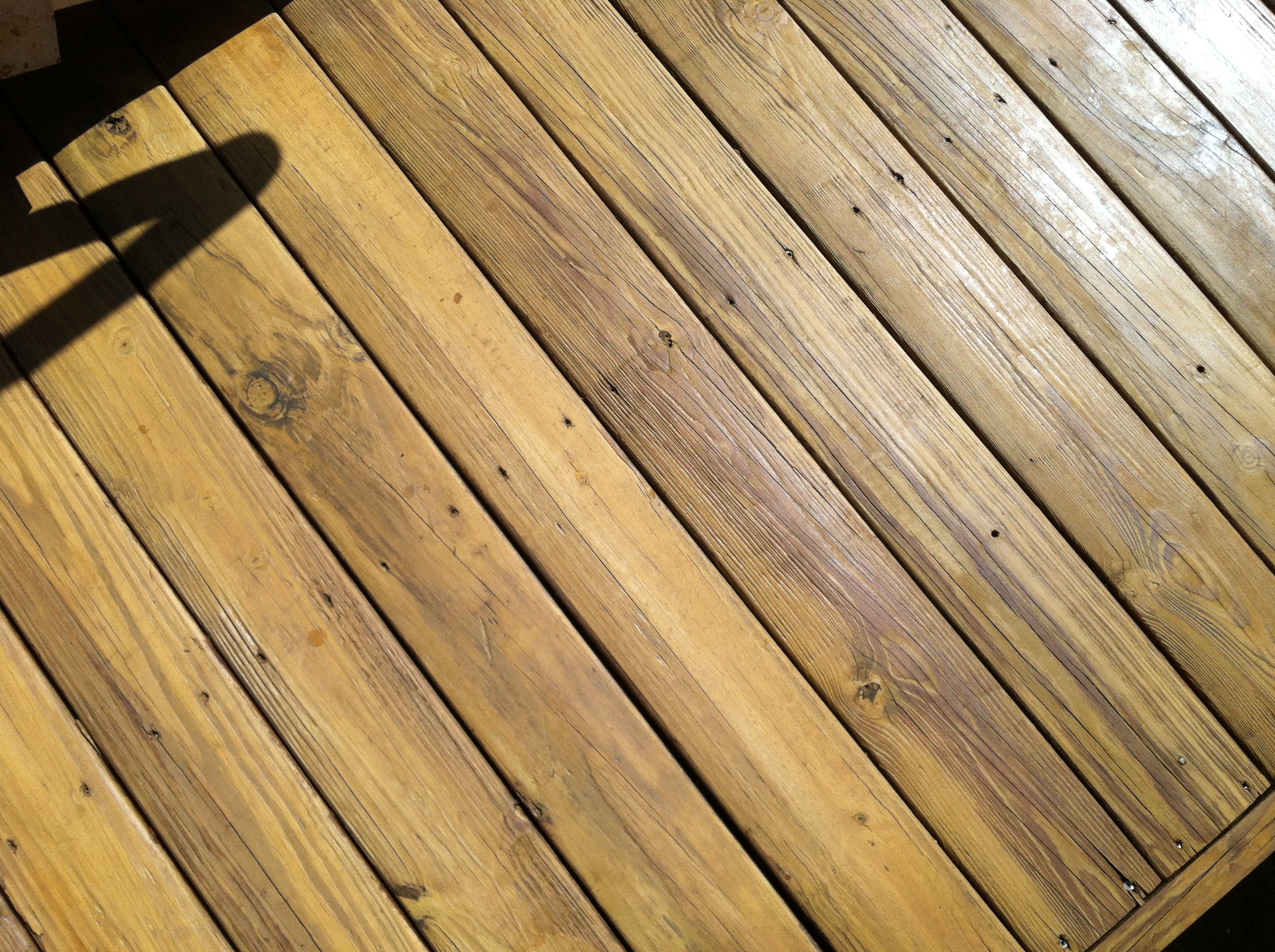

9 yr old PT pine
little shade in pm
No mold issues
Stain issue:
In 2011 I stripped my 1000% acrylic deck, sanded, washed & brightened it. I applied One Time Wood Stain. A few weeks after it cured I noticed what appeared to be inconsistent stain penetration. In Jan 2013 I stripped, sanded , washed and brightened my floating dock, and used a different stain. Several days later, the same problem: inconsistent penetration/saturation. It seems I'm doing everything I should but my final results aren't very good.
(@administrator)
Posts: 3341
Are you mainly concerned about the "white" areas where to stain does not seem to absorb or color the wood?
It could be one of two things:
1. Stain absorb deeply there and needs more to touch up and color
2. Something is stopping the stain to absorb. This could be a previous old coatings, sanded too smooth preventing penetration, etc.
