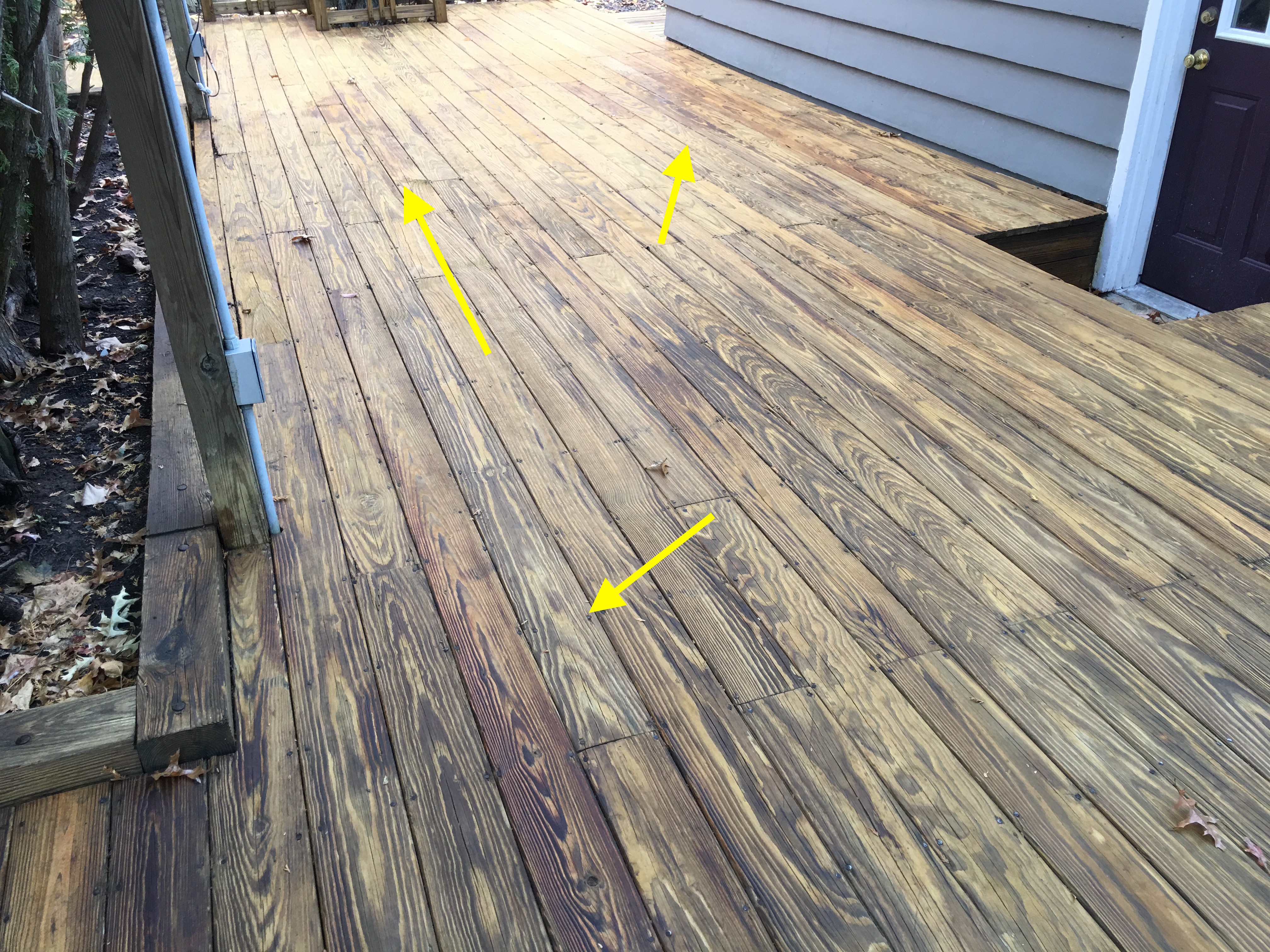

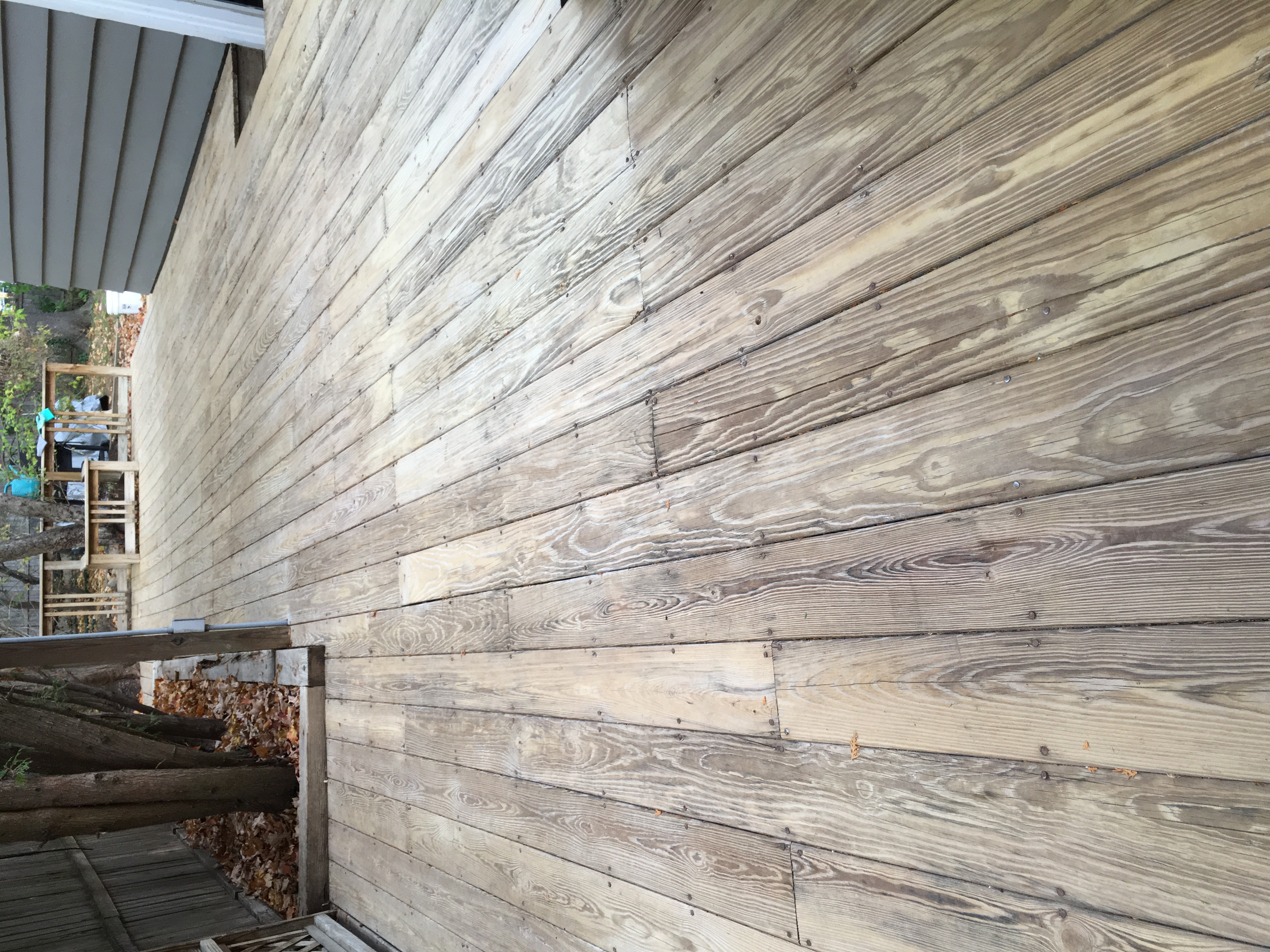

Looking at this new set of photos, you can see my final removal of the grey powdery paint texture.
You can also see the final stain, which is far more rich and bold than expected. Since the previous owner was a contractor, I believe he used whatever wood he could get his hands on to build this giant deck and save money, so there are many inconsistencies, though beautiful and we're very happy.
*QUESTIONS*
1) There are areas that didn't get enough stain, creating more of an inconsistency of tone than I prefer, this was impossible to detect during the process (I finished at sundown, then the rain). Will I be able to go over these areas again to attempt a more even coating — now, or next year?

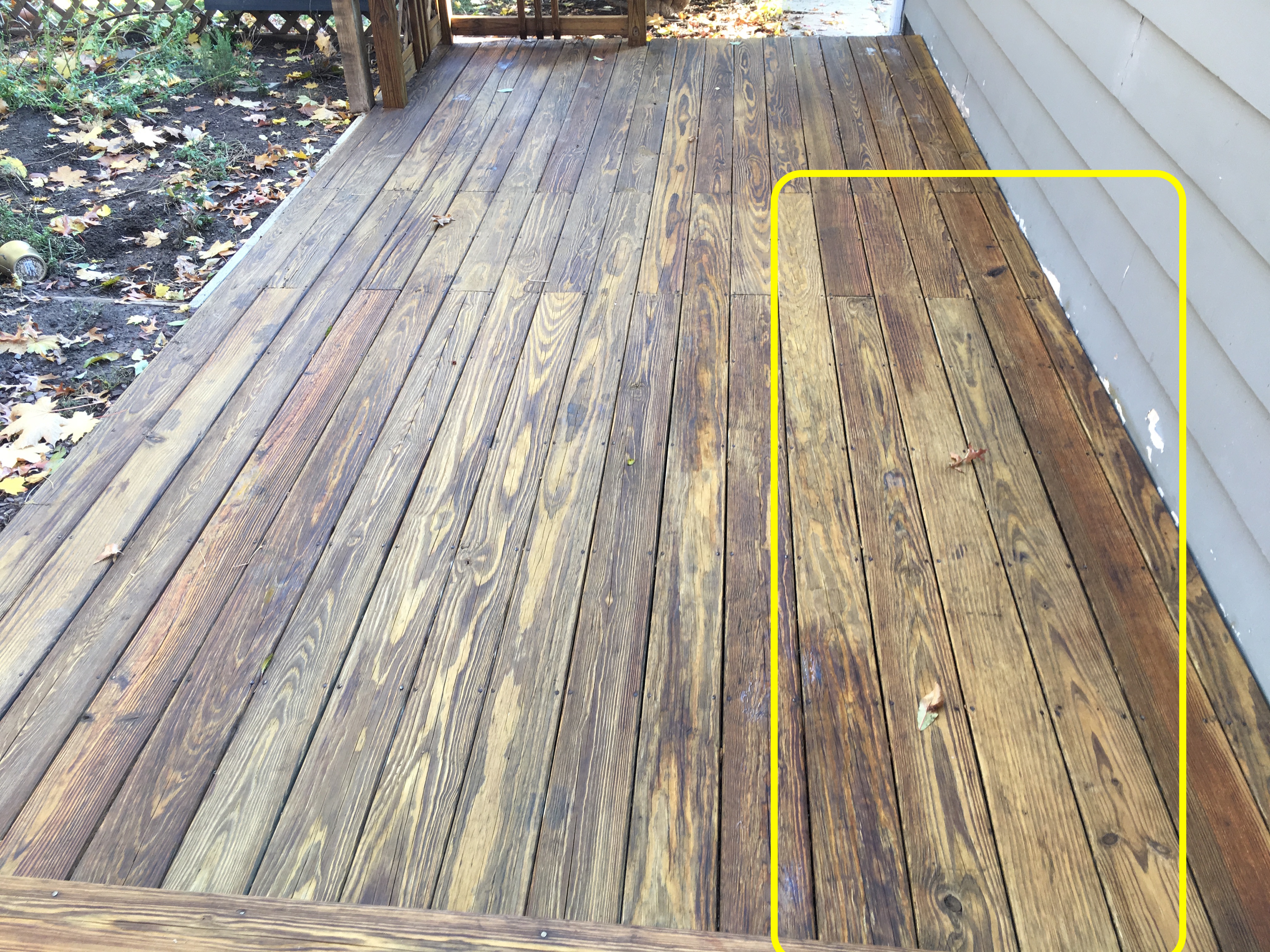

2) In the area highlighted with yellow, the lighter boards within the dark section - is it too late to touch up those boards with a 2nd coat?
3) If I understand correctly, in the future, I will not have to sand again, but instead I would wash the deck with water only and apply another coat of the Armstrong Amber. Is that correct?

It will show if you try to darken some boards and not others. We would leave alone and lightly clean next Spring and apply one coat to the entire deck. You do not wash with just water when reapplying. Use a mild deck cleaner to help remove any dirt, etc.
