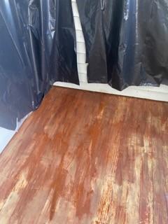

pic
 IMG 5984 Small

Looks like you will need to redo as it should be bare. Did you do the test spot first? This helps determine how thick to apply and how long to dwell before trying to remove it with a pressure wash. You may need to break it down into sections at a time.

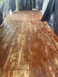

IMG 5999 Small
IMG 6001 Small
Douglas Fir
NY
Shade and sun
Just wanted to double check this before I move onto the brightening and staining stage…
This Douglas fir has been hit twice with the stain and paint remover, its definitely made a difference in removing some of the varnish but its seems patchy in areas…. Do I need to hit it with another round of remover? The varnish im using is dark walnut.
IMG_6001-Small
(@administrator)
Posts: 3341
Yes, you need to remove all old coatings that is still on there. When you say "varnish" are you using RAD Dark Walnut? It is not a varnish, but a penetrating stain.

Thanks for your prompt reply. Sorry yes im using RAD dark walnut as a penertrating stain, the previous finish was varnish.
(@douglasfir)
Joined: 2 years ago
Posts: 15
Do you think I need to redo the entire deck with remover or just the patchy areas?
(@administrator)
Posts: 3341
Posted by: @douglasfir
Wherever you still have any old stain/shiny coating will need to be removed. Let the stripper sit longer, it will come up better.

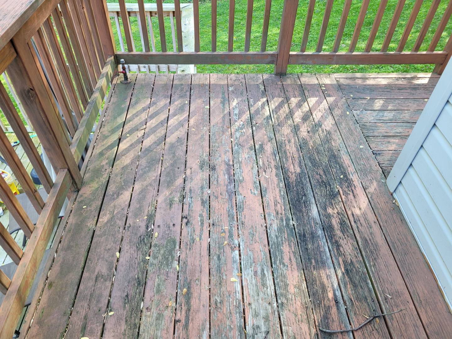

I'm re-staining my deck and want to confirm recommended cleaning/prep and # of coats (solid stain). See below for details.
New Wood or Older Wood? - Older (about 20 years), partial shade (southeast PA), and a portion is covered by roof.
Does the Deck have a Current Coating? - Solid stain, applied 10 years ago
Are you Switching Brands of Deck Stain or Applying a Maintenance Coat of the same Brand and Color? - Switching to DEFY Extreme, similar color to existing
Deck Stain Brand Previously Used? Enter “unknown” if you do not know. - One of the big box store brands
What is the Current Deck Stain Type? Oil-based or Water-Based? Clear, Transparent, Semi-Transparent, Semi-Solid, or Solid Stain? - solid water-based
Mold or Mildew Issues? - see photos
20240420 173815
20240420 173717

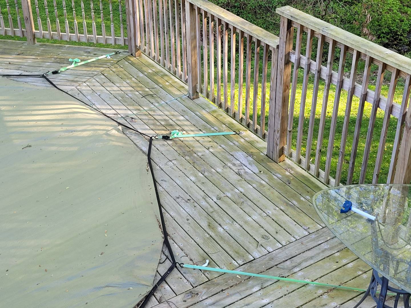

I'm staining my pool deck for first time. The deck has weathered for about 3 years and I want to confirm recommended cleaning/prep and # of coats (solid stain). See below for details.
New Wood or Older Wood? - Older (about 3 years), partial shade (southeast PA).
Are you Switching Brands of Deck Stain or Applying a Maintenance Coat of the same Brand and Color? - Using DEFY Extreme solid stain
20240420 173743

  See this for solid stain recoating tips: https://www.deckstainhelp.com/how-to-reapply-a-solid-color-deck-stain/
You will need 2 coats. Might want to look at the RAD Solid Stain as well.

Clean and brighten this oxidized wood for prep. 2 Coats of the solid stain.
